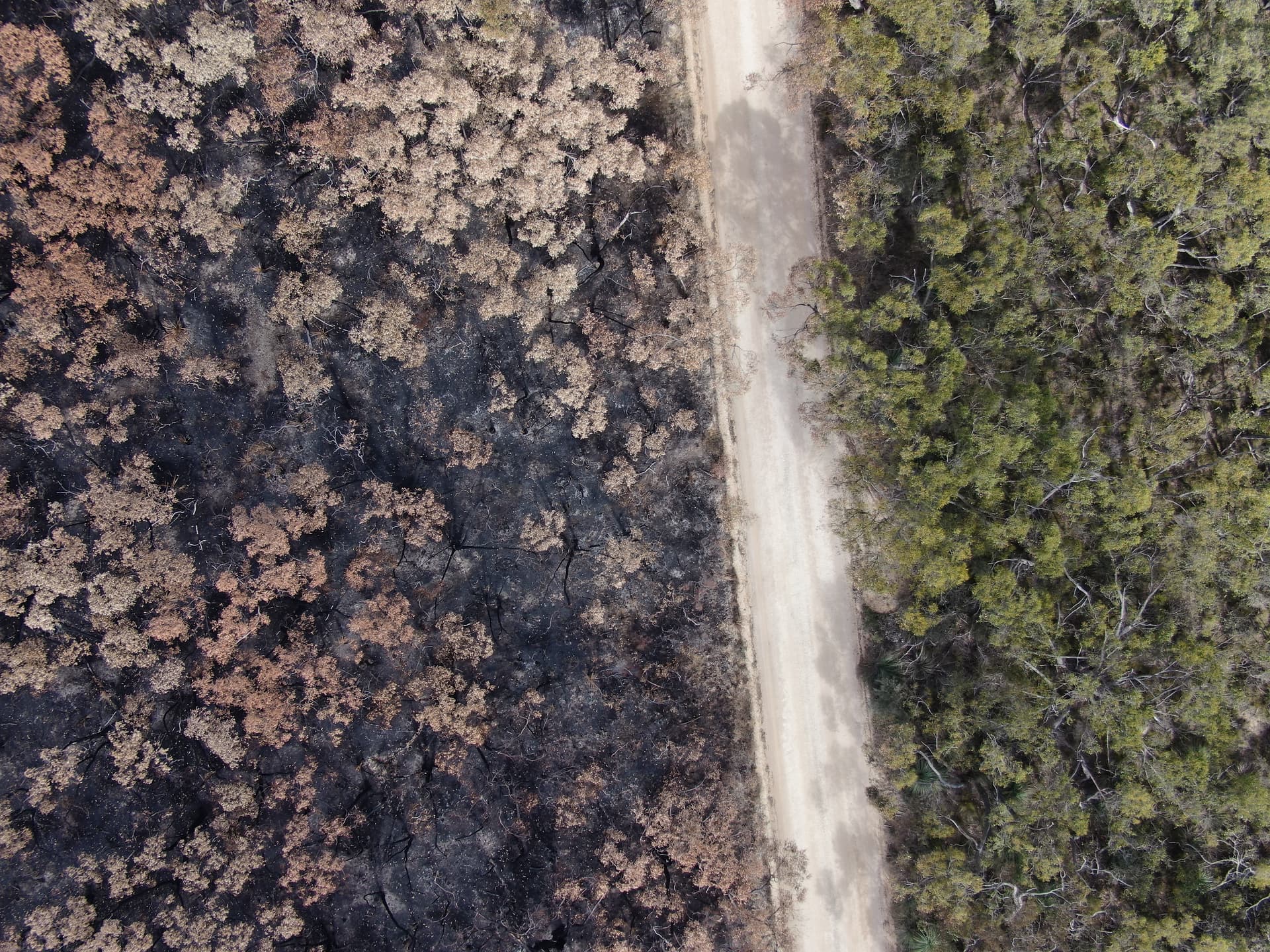

I use the Mavic 2 Pro setup in HQ mode for the camera. The camera profile built into the camera database is setup for this camera with full FOV. I created a XML that works but not sure if it is correct. Can someone verify if I share some images?
Using the Mavic 2 Pro on a recent flight, I captured 400+ images, I am getting missing areas in the map using the camera profile I setup. I don’t know if the missing area is because of the profile or something else. Is it possible for someone to help me figure out why the map is missing areas?

I also added a screen shot of the missing parts of the map. There are 400+ images.

Find attached the XML. About the missing parts, try to increase the overlap and fly little higher, this may be the cause of bad map alignments.
