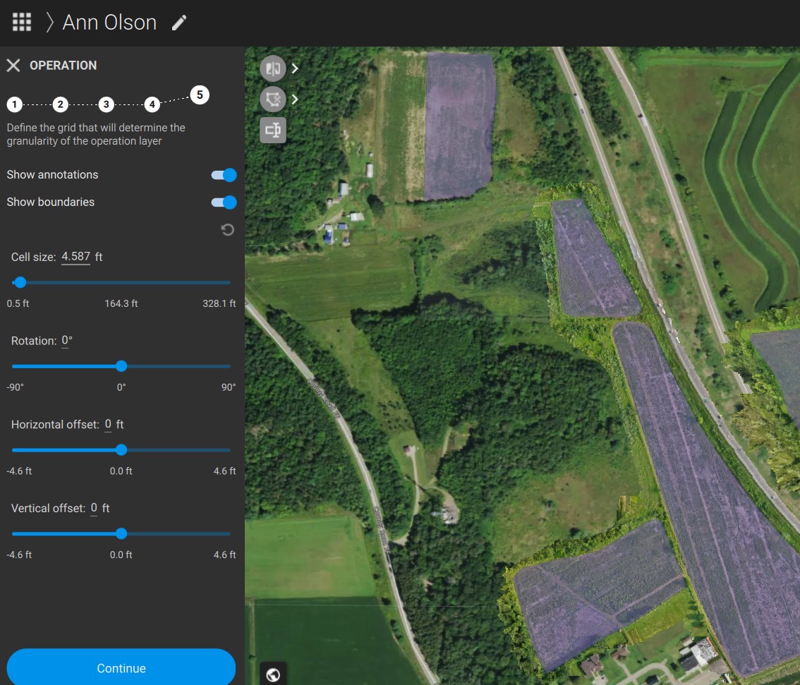

Simply, I’m trying to create a spray plan under a boundary I’ve defined that is filled with annotations as my fields. Typically this does a good job of just summing up the area and calculating the total gallons required just from the annotation data. However, this area to the west (two small plots) seem to be clipped out. Any ideas what I’m doing wrong? It works fine for other fields.
Hi, it seems the marked area is not marked in the actual prescription with the purple zone, you need to use the brush to actually mark it as a field. Are you sure that these fields are in the same annotation as the othe fields? Share a screenshot please
