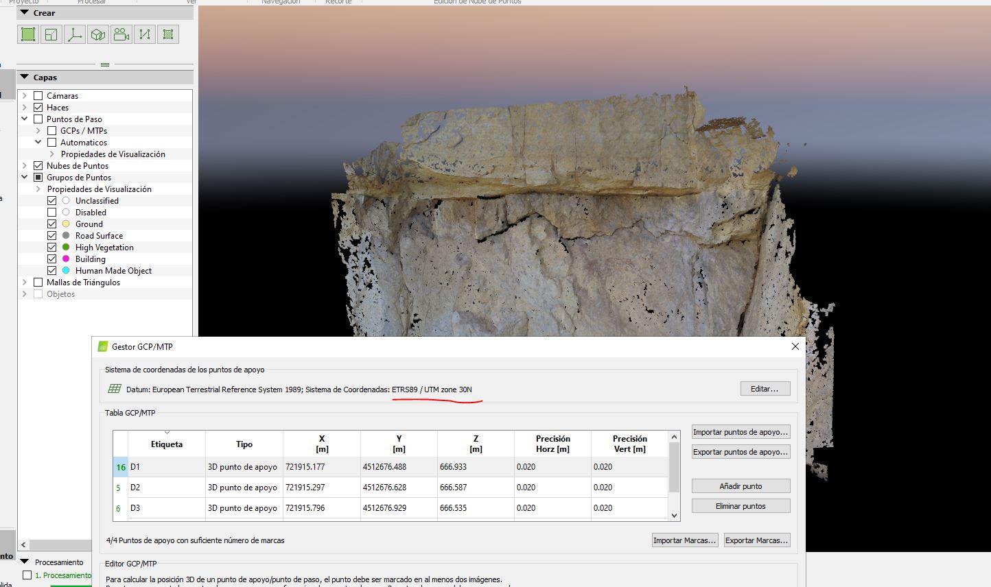

I took some images with the Anafi Thermal manually. This images doesn’t have coordinates so I start the project in Pix4D Mapper with a local system.
When I’m processing everything is fine (if I process all the steps all work) until I give 3D coordinates manually (this coordinates come from a total station). After re-optimize my pointcloud it’s hidden and disappears.
I attach a screenshot of the result
and the report panel_1_ter_report.pdf (257.9 KB)

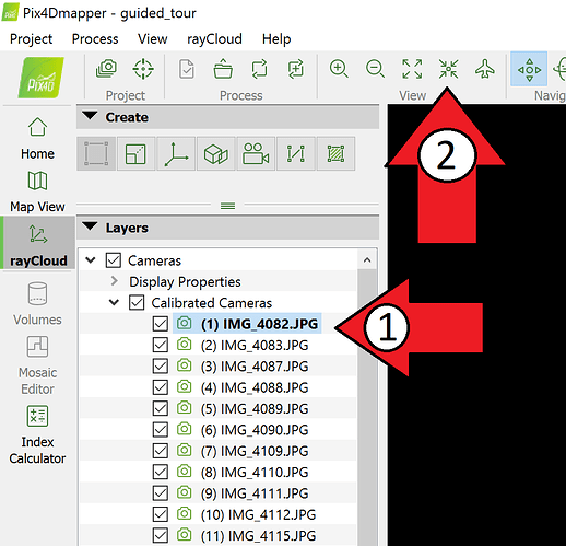

Hi Joan, The RMS error also seems to be high. Can you try selecting one of the cameras in the layers panel then select focus on selection button? See the image below for more info. Does the pointcloud appear? If not please respond with the log file.

the issue it’s solved! I followed that workflows before, but as I was adding the 3D GCPs manually in the raycloud, I forgot to select the coordinate system of the GCPs!! -.-’
Thank you for your help!
