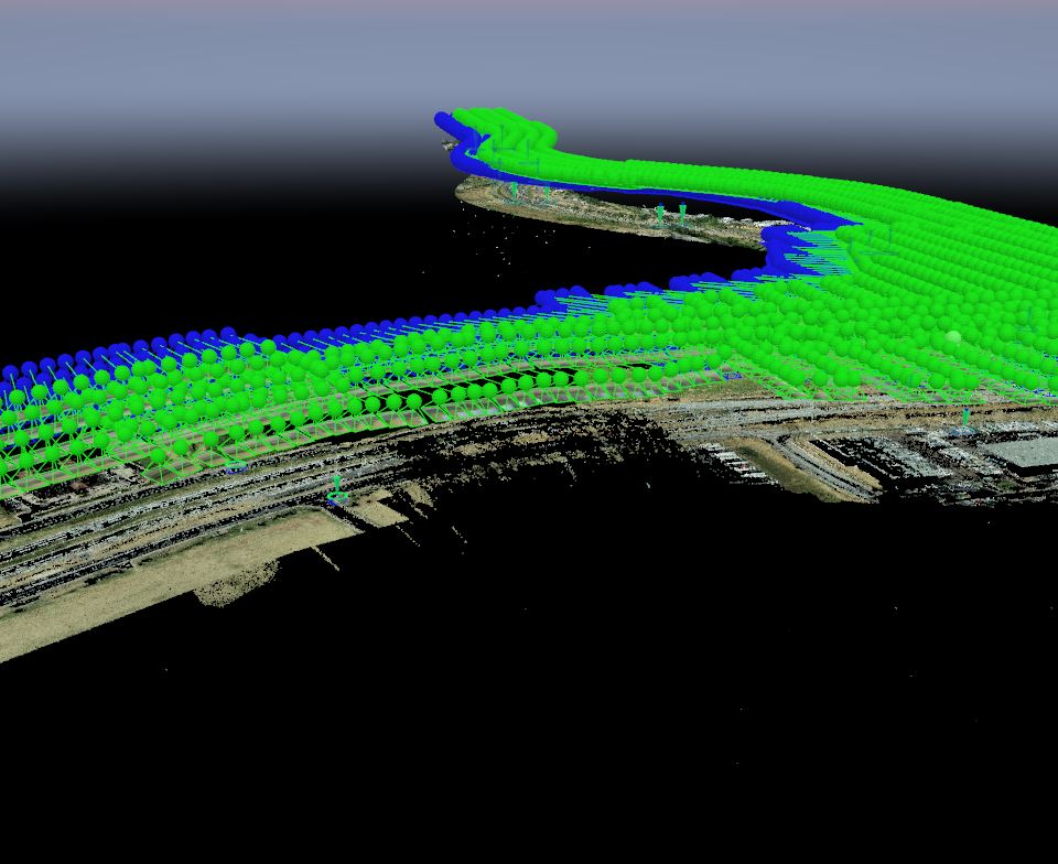

Processing: Screenshot (2).bmp…
Why are some initial projections BLUE pointed up? PPK Georeferenced. Lots of GCPs. Using WGS 84 NCRS (Nevada Coordinate Reference Systtem) PRJ.
Are you by any chance using DJI Zenmuse P1 in this project? If yes, there was a know issue with the camera orientation that got fixed in PIX4Dmapper 4.7.3.
I would recommend you to make sure that you have the latest firmware installed on your drive and that you process in the latest PIX4Dmapper version.
You can download PIX4Dmapper here.
Best,
yes I am using the P1. I will check the Firmware versions and upgrade. Thank you.
I am not using the smart oblique on this one. It is Aerial Grid. Still getting the calibration errors.
What firmware on drive are you referring to?
“I would recommend you to make sure that you have the latest firmware installed on your drive and that you process in the latest PIX4Dmapper version.”
Hi,
Blaz is referring to the GPU drivers. If you are using Nvidia you can download the late version from this link:Official Drivers | NVIDIA.
Have you installed the 4.7.3 PIX4Dmapper? Can you share with us the quality report in pdf format and the log file?
