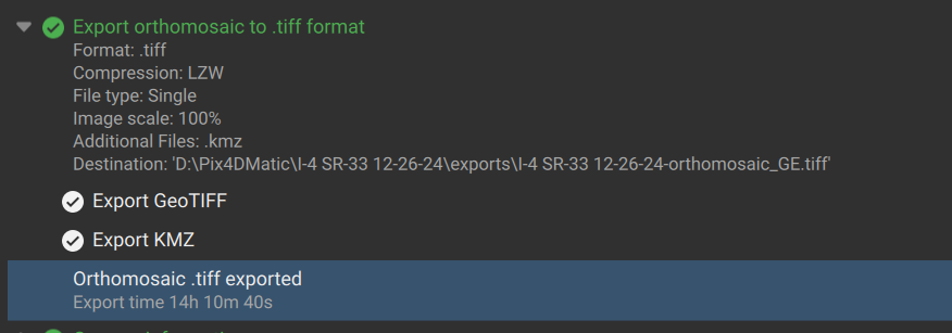

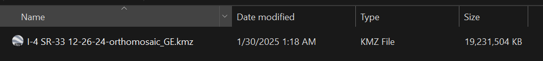

Tried this yesterday. Took 14hr and trying to load into Google Earth I get a “No results - empty KML file error”. Resulted in a 19GB KMZ vs 21.7 GB for the TIFF. Also, I couldn’t figure out how to generate just the KML/KMZ and not regenerate the TIFF which I already have.
Think I’ll pass on this “feature”
Hello!
I believe that there might be a maximum size of a KML or KMZ that can be imported to Google Earth. This page by Google Support provides some details, it mentions that
unzipped KML and KMZ files can be up to 1GB
and it looks like that the same limitations apply to the desktop version of the product.
One thing you can try to do is to export the orthomosaic at 25% image scale to reduce the size of the file, if the result is still larger than 1GB then another option is to generate lower resolution DSM and orhtomosaic (by setting “Custom” resolution for DSM) and re-export them to KML/KMZ.
