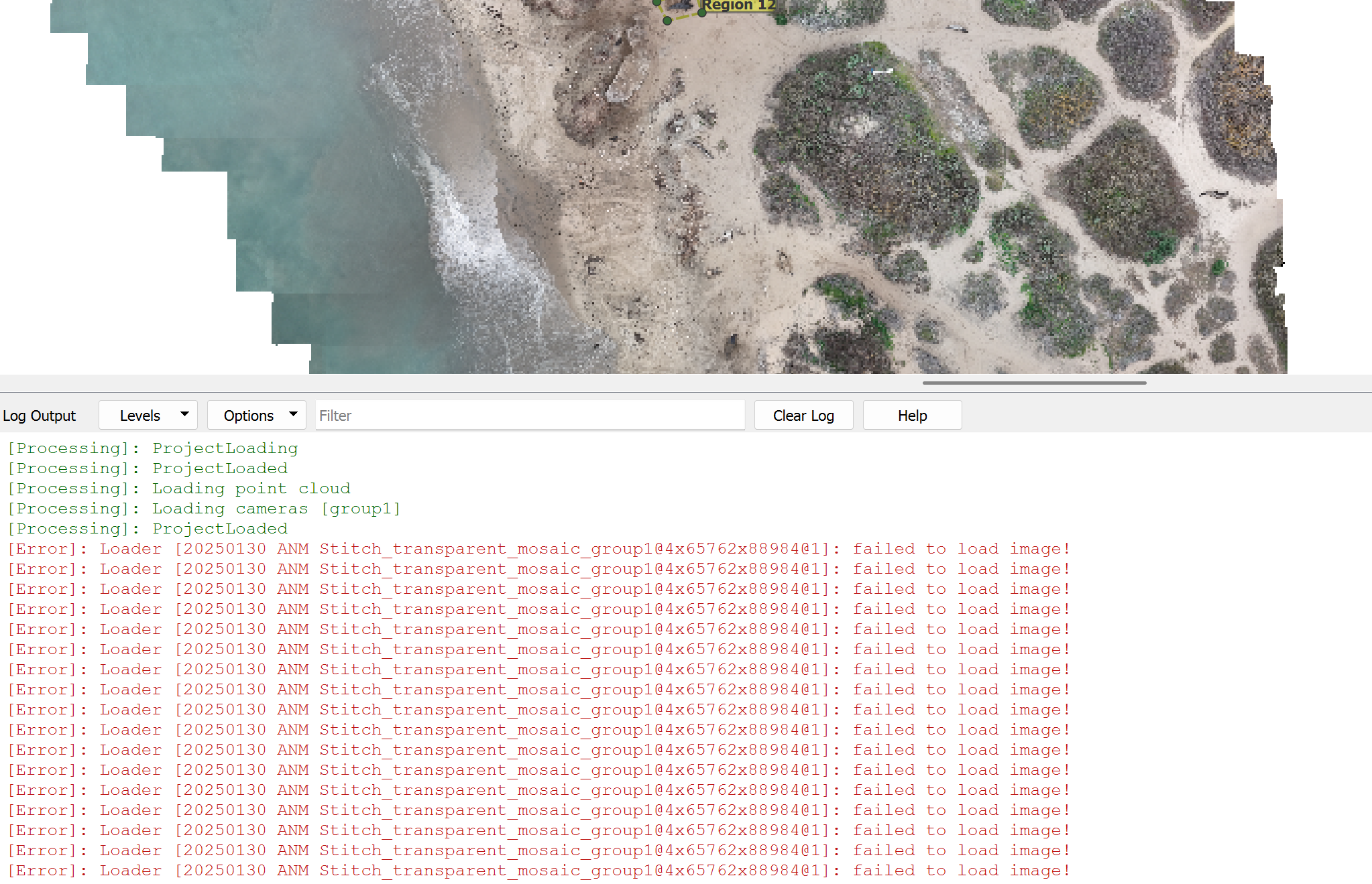

I recently got a new computer adn have tried to move all of my Pix4D projects to that new computer with an external harddrive. Even if when I zip the accessory files before moving, I can’t fully load the orthomosiac on the new computer. I can open the pix4d project, and I can open the orthomosaic tif separately, but when I load the mosaic edior the images only half load and remain blurry. The Log Output is full of : [Error]: Loader [name of file_mosaic_group@4x12390x5909@1]: failed to load image! messages.

Yes; I reset the directory to the image folder and can load the project fine. I can open the mosaic editor too, it just doesn’t load at the resolution it does on the old computer and it gives me those errors.

Here’s the log! This is after clicking Mosaic Editor. As you can see the mosaic loads, but it’s pixelated and blurry.
Sorry, we need the .log file. The screenshot doesn’t help. You can find the .log file in the file path below.
