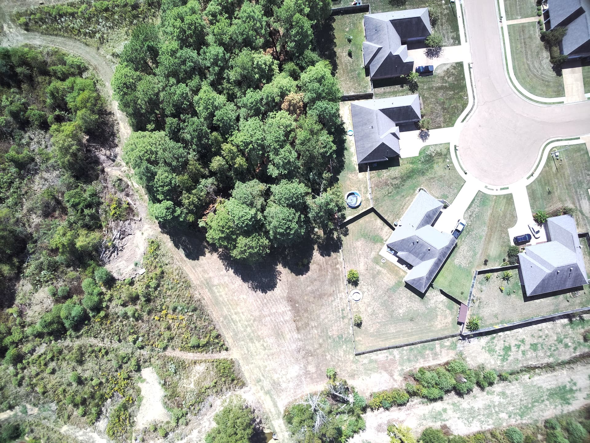

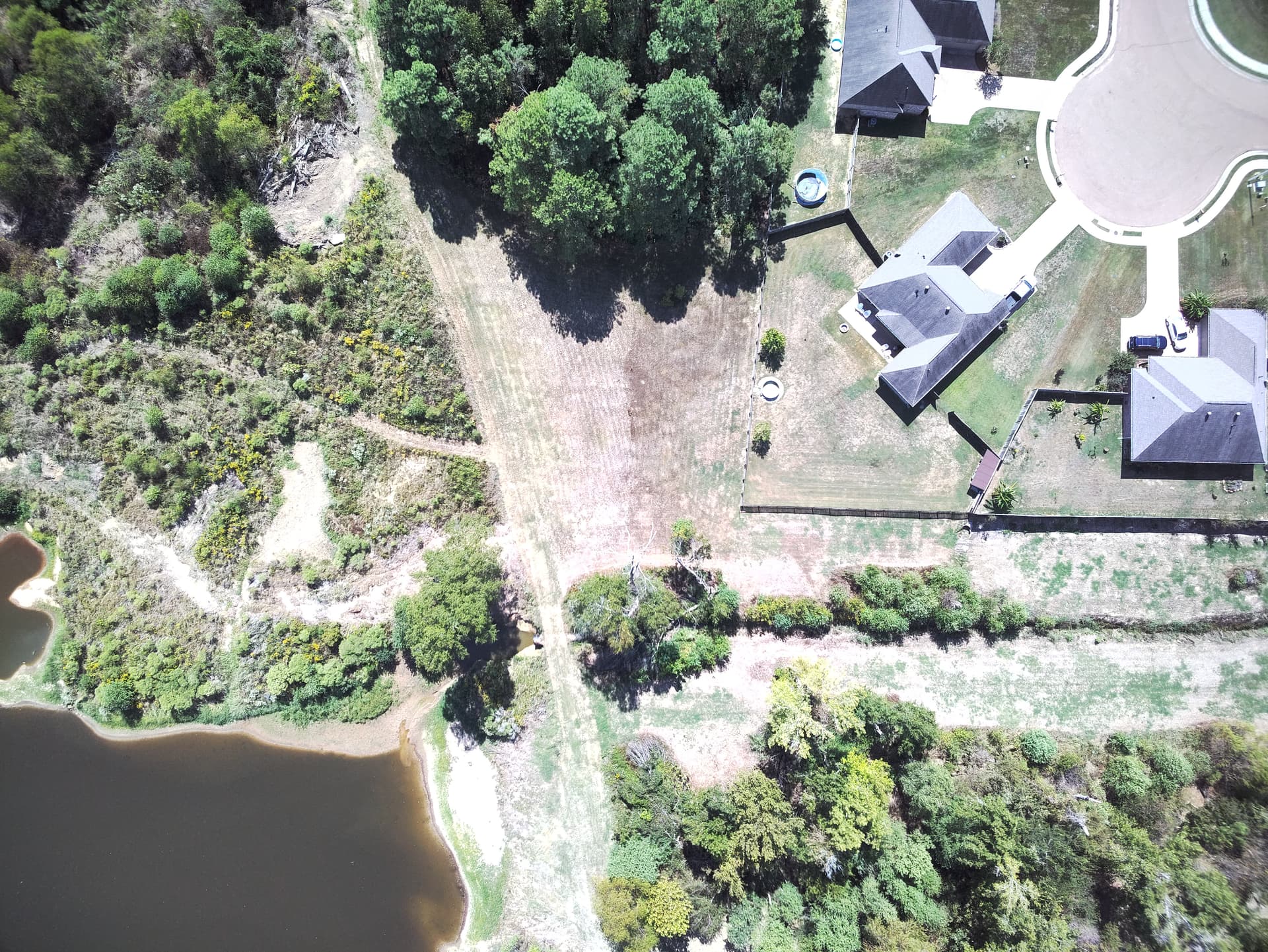

Could we get the xml for Teal 2?
Hi droneMDAC,
I tried creating an XML file for these images but there is something wrong with them. They do not contain the necessary exif tags on the images. It appears that they are lacking any georeferencing along with the make and model of the camera.
I suggest reaching out to the manufacturer. They might need to make some adjustments to their firmware.

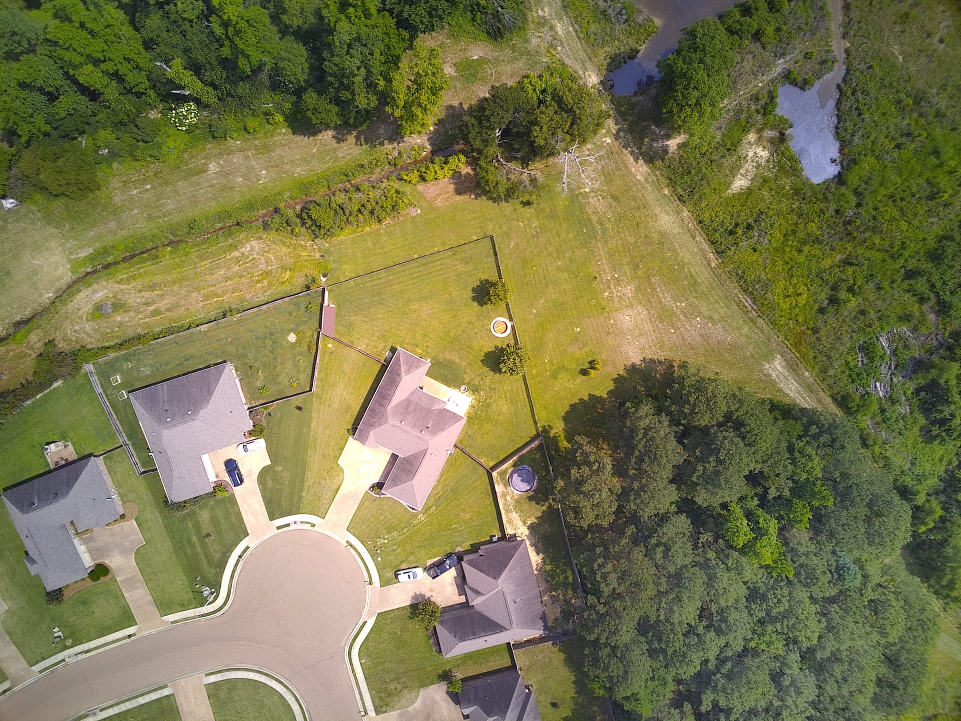

After sending that email, I remembered seeing lat/long somewhere. I am actually seeing the lat/long when I Get Info on the files…see attached
When I download the files that I sent you folks previously, the file does not have that data. just weird!
I can view the full details of the exif data online
of this image
| BitsPerSample | 8 |
| CameraPitch | -89.93351 |
| CameraRoll | 0.005986 |
| CameraYaw | 0 |
| ColorComponents | 3 |
| Date | 2023-05-26 16:04:11 UTC |
| DateTimeOriginal | 2023-05-26 16:04:11 +0000 |
| EncodingProcess | Baseline DCT, Huffman coding |
| ExifByteOrder | Little-endian (Intel, II) |
| ExifVersion | 0230 |
| FileAccessDate | 2023-05-30 15:27:31 +0000 |
| FileInodeChangeDate | 2023-05-30 15:27:31 +0000 |
| FileModifyDate | 2023-05-30 15:27:31 +0000 |
| FilePermissions | prw------- |
| FileSize | 0 bytes |
| FileType | JPEG |
| FileTypeExtension | jpg |
| FlashpixVersion | 0100 |
| GPSAltitude | 212.1 m Above Sea Level |
| GPSAltitudeRef | Above Sea Level |
| GPSLatitude | 32 deg 31’ 22.35" N |
| GPSLatitudeRef | North |
| GPSLongitude | 90 deg 8’ 50.27" W |
| GPSLongitudeRef | West |
| GPSPosition | 32 deg 31’ 22.35" N, 90 deg 8’ 50.27" W |
| ImageHeight | 3472 |
| ImageSize | 4624x3472 |
| ImageWidth | 4624 |
| JFIFVersion | 1.01 |
| MIMEType | image/jpeg |
| Megapixels | 16.1 |
| ModifyDate | 2023-05-26 16:04:11 +0000 |
| ResolutionUnit | None |
| XMPToolkit | GStreamer |
| XResolution | 1 |
| YCbCrSubSampling | YCbCr4:2:0 (2 2) |
| YResolution | 1 |
