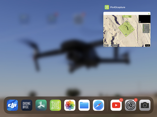

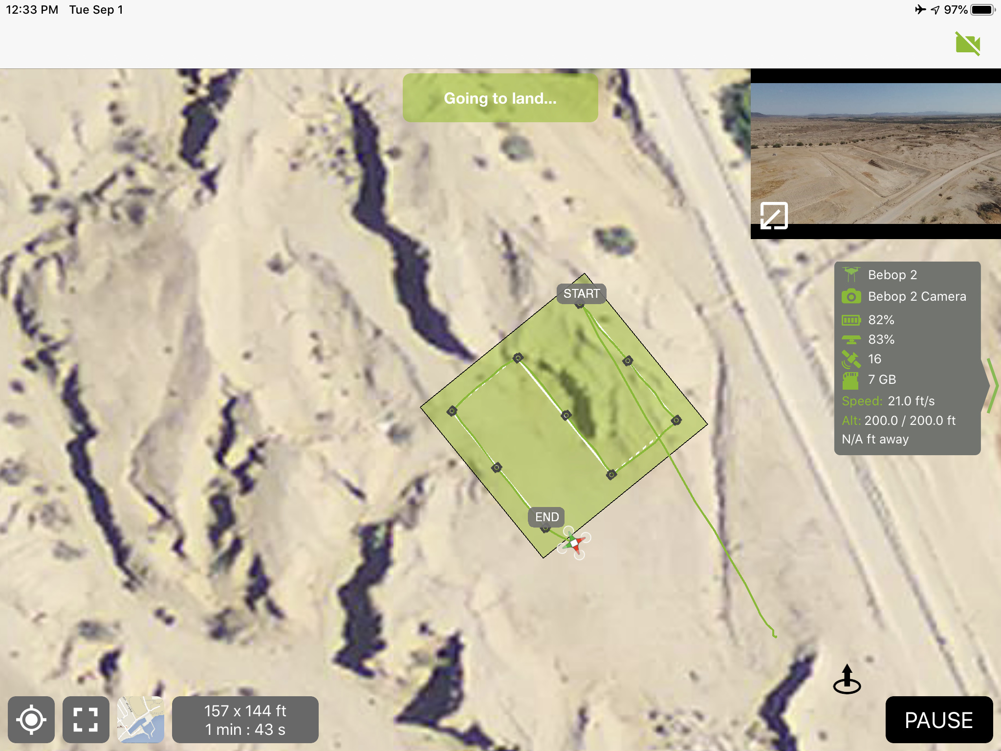

Here’s a screenshot, since the Pix4D team doesn’t seem to believe us. My M2P in flight on a BS mission, and look, no image. Another screenshot to show that I have no other applications open (ever. Closed everything before connecting and launching pix4d). Funny though, my Bebop 2 had a picture just fine on the same day with the same iPad. Hmm…
