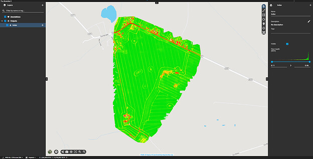

Histogram is displayed by default in the Index layer
PIX4Dcloud and PIX4Dcloud Advanced support the display of indices for agricultural purposes.
They are hanging from Ouputs in a layer called Index.
They are generated after a process but also by using the Share-to-cloud functionality from PIX4Dfields
The Index layer will behave the same as the DSM layer and it will contain the histogram of the whole area:

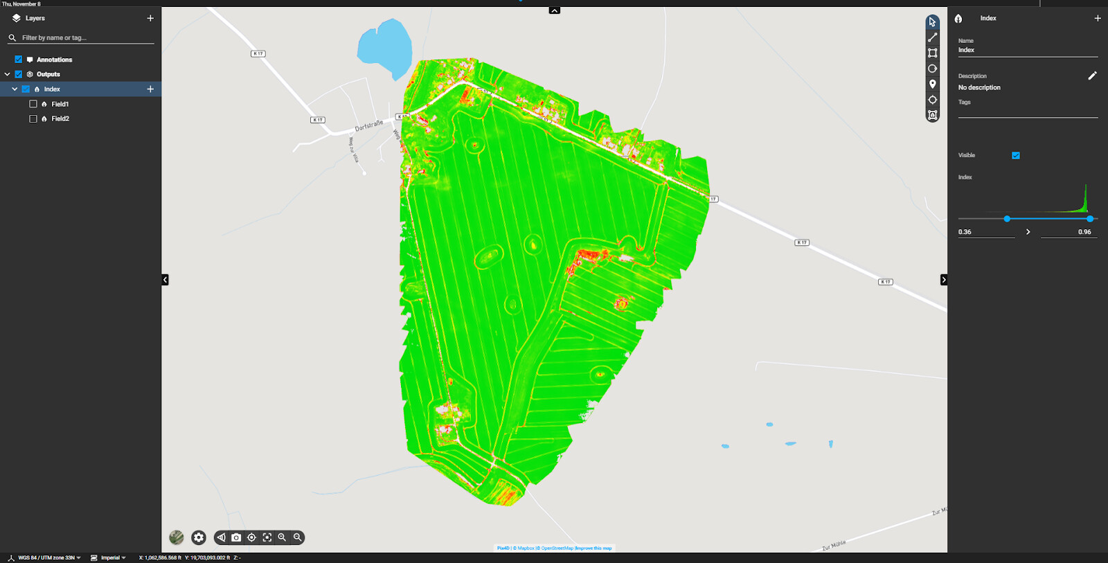

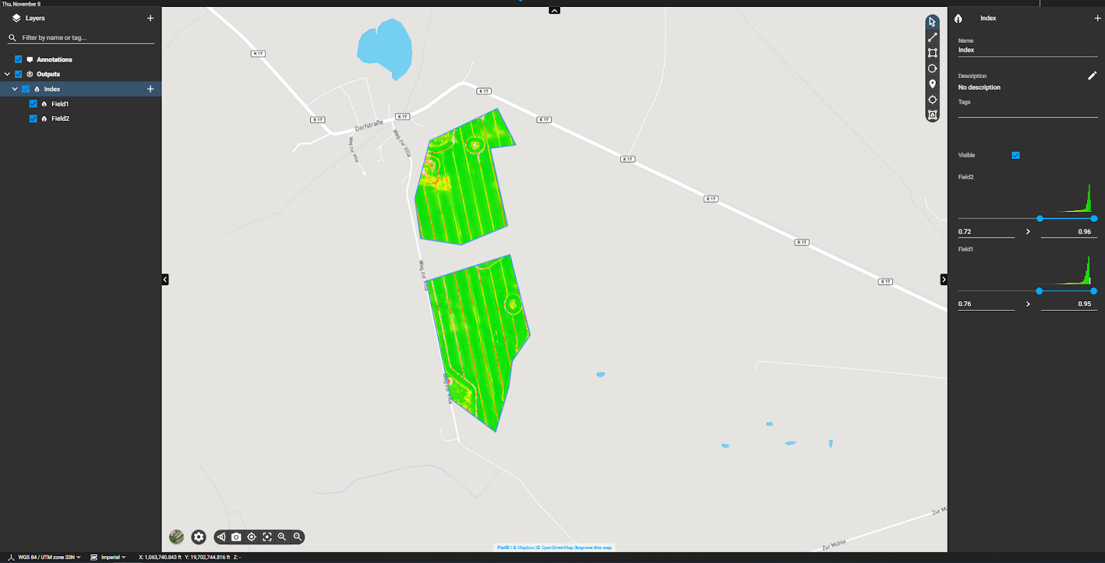

If the Index layer contains Fields, the individual histograms will continue being displayed:
If the Fields are not checked, the software will get back to the histogram of the whole area:
In previous versions, only the histograms of the Fields were displayed and it was not possible to see the histogram of the complete area.
