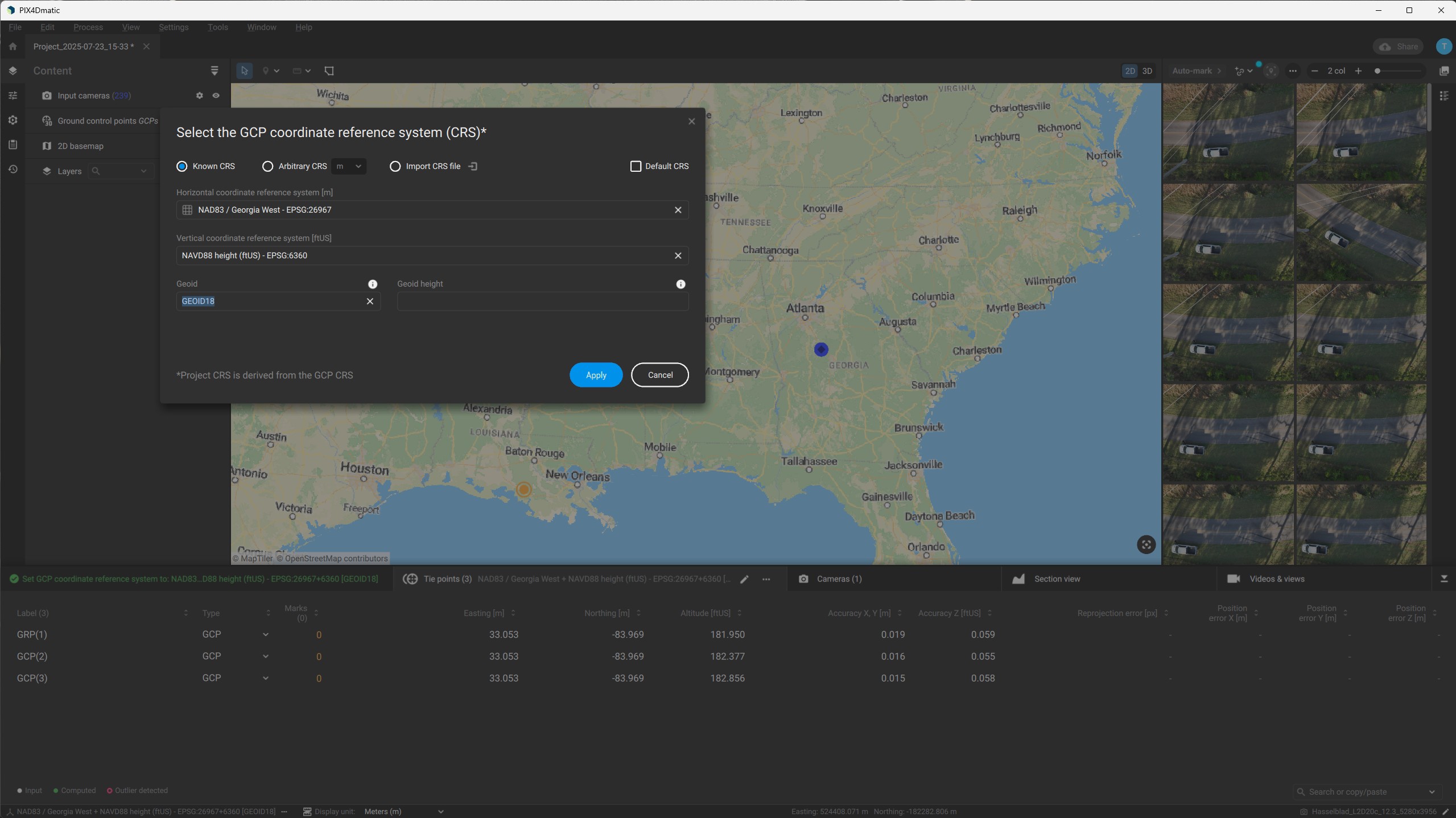

I am having issues with the horizontal and vertical reference systems along with the Geoid #. The project I have been shooting has been in Monroe county Georgia. In the past I have been using:
Horizontal = WGS 84 - EPSG: 4326
Vertical = EGM 96 - EPSG: 5773
Geoid = 96
However, these are not the specific CRS for my location, which is strange because is always puts my GCPs right at the site I mapped.
When I enter what Pix4DMatic says is correct for my area:
Horizontal = NAD83/Georgia West - EPSG: 26967
Vertical = NAVD88 Height (ftUS) - EPSG: 6360
Geoid = 18
It places my GCPs all the way at the coast in Louisiana.
When looking at your Tie points table (your second screenshot), the coordinates appear to be in longitude/latitude which is consistent with WGS84. What you need to do is change the GCP coordinate system to WGS84. If you keep in stateplane (NAD83/Georgia West) then it will put the GCPs in the wrong place.
