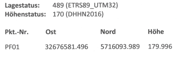

I tried to plot PF01 using ETRS89_UTM32, and it is not appearing in Europe. Could you verify with your surveyor if these coordinates are correct, or if the CRS used is EPSG:25832?

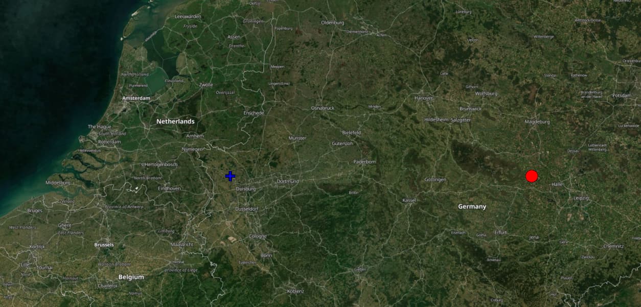

While checking the Quality Report, I noticed that it is mainly the X value that looks unusual. I tried experimenting a bit with the coordinates — instead of 32 676 581.496 I entered 326 765.81 — and this brought me closer to my image coordinates (see attached screenshot). However, the GCPs are still positioned slightly too far west.
I will update you once I have feedback from the surveyor.

              Hi @thea.blaettermann
Thank you for your reply and the screenshots.
It seems that the “northing” is exactly the same for GCPs and images.
Is the location of the images correct (south of Magdeburg, west of Halle)?
If yes, the “easting” in that area should be around 67x’xxx and 68x’xxx.
I will wait for you to get feedback from the surveyor.

              Hi Daniele,
After discussing the issue with the surveyor, I learned that my GCPs were actually provided in EPSG:3044 rather than the expected EPSG:25832.
The key difference is that in EPSG:3044, the zone number 32 is added to the Easting, which produces 8-digit values (e.g. 32 676581.496).
The fix is straightforward: simply subtract 32,000,000 from the Easting. For example:
32676581.496 – 32000000 = 676581.496.
This matches your assumption, Daniele, that the Easting values in this region should fall within the range of 67x’xxx to 68x’xxx.
Once this adjustment is made, the coordinates align correctly. At that point, it makes no practical difference whether the project in Pix4D is set up as EPSG:3044 or EPSG:25832, since the coordinates now match. After correcting and importing the GCPs, I was able to reoptimize the project without issues.
