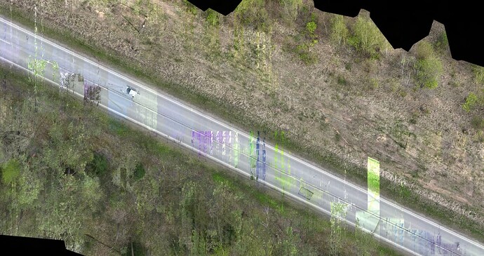

Hi, processing large corridor with Pix4D Matic, flight with Mavic3E RTK, corridor with three lines, frontal overlap 85%, side overlap 70%, perfect image quality, ISO100, cloudy mostly. Road with some, but not much trees on sides. Problem is, final orthophoto has a lot of arthefacts in images. Thing is, when same imegery is processed with Pix4D Mapper, results are perfect. Example picture:
Hi Lauris,
Could you please let us know which version of PIX4Dmatic you are currently using?
This issue was addressed in version 1.72. If you are working with that version or a newer one, we will need access to the dataset in order to investigate the issue further.
Best,
Diana
Im on 1.71.0, will upgrade and report.
Thank you, problem solved by new version 1.76.0
