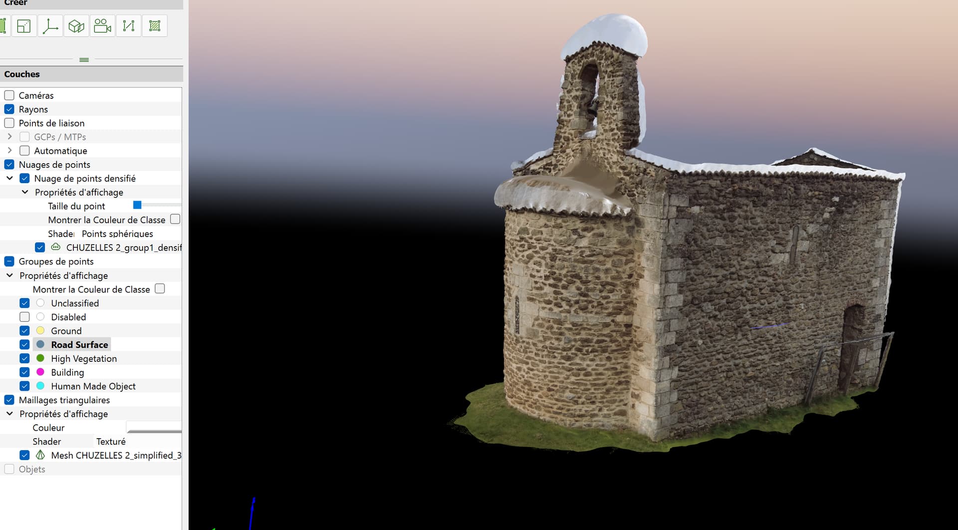

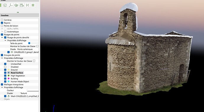

Hello, I don’t understand why I have this rendering… It looks like snow.
Hello,
This is most likely because you captured sky in your images. It is best practices to not capture sky in your image acquisition. But you can edit the point cloud and disable the erroneous points. This should help correct this.
