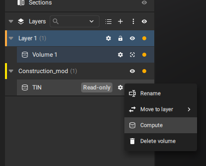

But can’t find how to implement. I brought the surface in through File→Import, and it shows as a new layer. But how do I choose it for the base surface for the volume calc?

The imported LandXML is the base surface to calculate the volume. Once the LandXML is imported into PIX4Dsurvey, it creates a new layer with the file, then you can compute the volume using the “Compute” button in the toolbar or doing clicking on Compute inside the geometry actions button
Clicking Compute on the imported surface just gives me a “Not enough memory for volume computation” error. I have 64GB.
Hello,
Thank you for reporting this issue. Could you try importing a smaller surface and see if the volume processing works for it?
Kind regards,
Alexey
