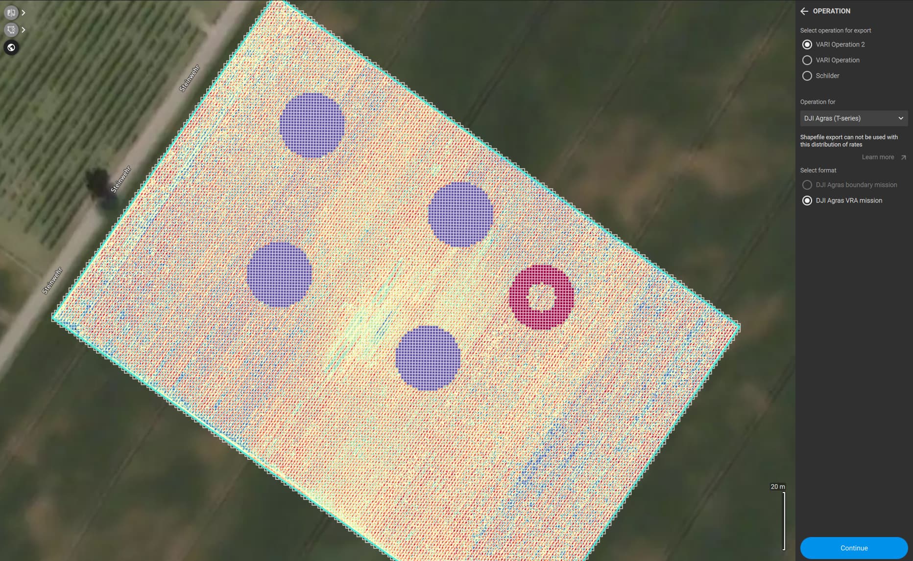

When attempting to export an operation with all cells selected at the same rate, I get a message that “Shapefile export can not be used with this distribution of rates”. I would like to export a DJI Agras boundary missions, but that option is greyed out. When I export a VRA mission, I see both Rx and ShapeFile folders created, with a .tfw and .tif file being created in the Rx folder, but nothing in the ShapeFile folder.
I have followed the no special characters rule mentioned in a previous post, but am still having issues.
Can you share a screenshot of your mission? The DJI AGRAS boundary mission has certain limitations.
For example, this would work:
But if you have “donuts” like this, it will only work with a DJI Agras VRA mission, so make sure you have no rates inside of other rates. This is a limitation of DJI.
As you can see, I have created multiple sub-polygons, and I also have three “holes” as the more detailed screenshot shows.
One interesting point, when I created the operation using existing annotations, there were a handful of cells which were randomly populated to rate 1 as shown here. However, creating without pre-filling the grid did not change the ability to export a boundary file.

that’s most likely due to the hole you have in your boundary on the north-east corner. That is not supported for boundary missions as this generates a zero rate zone, which will lead to the mentioned “donut”.

That area here is the problem, as it creates a hole which is not supported.
When deleting that part you can see the export works:
