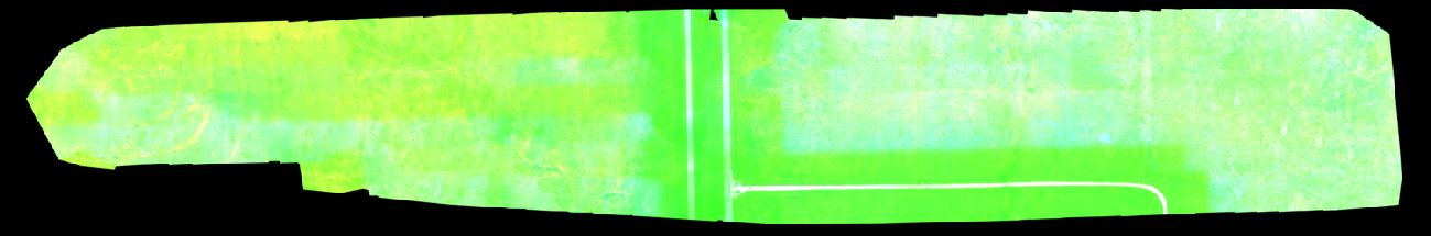

I am confused about band assignments to rededge M imagery processed by pix4d. Is layer1 = blue or red? I am trying to create a natural color composite, and it doesn’t look natural. I have tried layer1=blue, layer2=green and layer3=red and also layer1=red layer2=green and layer3=blue. Both look unnatural. This is a tallgrass prairie site in central KS. Should be green with some tan/brown bare ground, but not yellow and certainly not blue. Also, does pix4d not create a 5 band composite ortho? I only see the reflectance images for the individual bands and not a composite in the output
