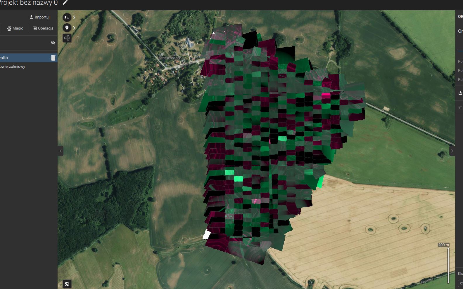

Hello! Since two days I am testing the Pix4DFields. I have no idea why as the result I have mosaic like on the photo below. Is that because I am using Trial Version? Or am I doing that wrong way?
Hi, this is related to outdated graphics card drivers. To solve this:
  • Update graphic card drivers.
  • After updating drivers and restarting the device, process the imagery again.
  • If the problem persists, import the imagery again and disable GPU acceleration under Advanced settings - Processing options.
