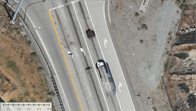

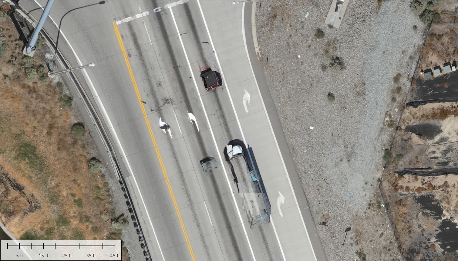

Screenshots below. The masking workflow seems more time consuming than the old approach. I was able to remove most of the cars pretty quickly via masking, but spent a lot of time trying to get the last few remnants removed. Unsuccessfully.
Before:
After:
Before:
After:
