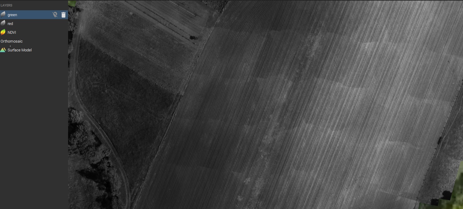

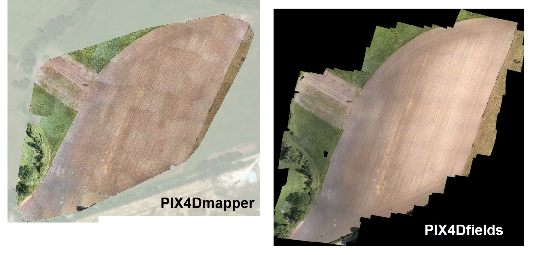

With PIX4Dfields, the artefacts on the RGB mosaic are less visible :
For the reflectance maps, there are still here :
On the green @alealbuquerque images, there is not artefact…

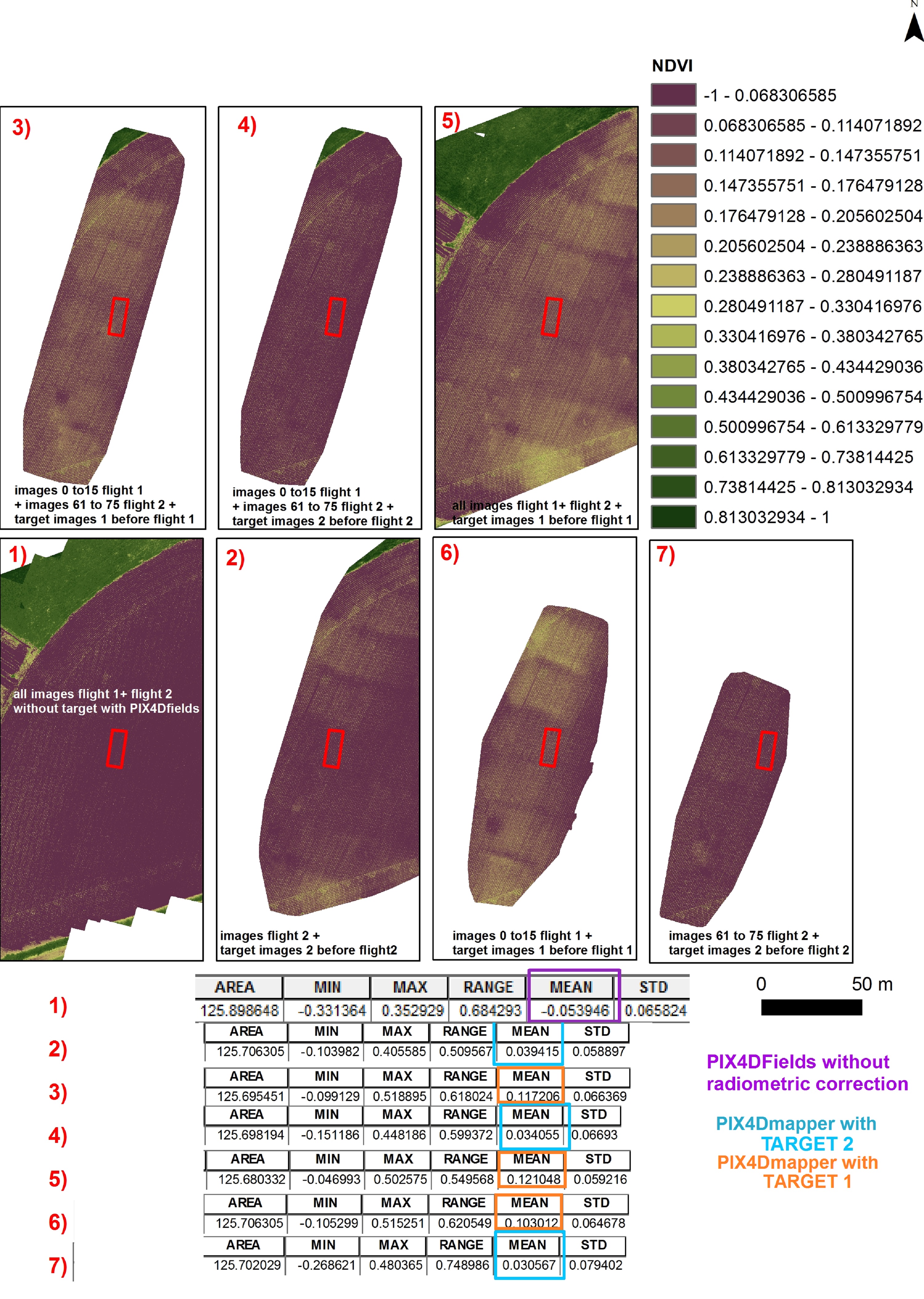

For the LCI and MCARI, there are some stripes but for NDVI, red and green reflectance maps, it seems good.
So I can’t correct the data and this software doesn’t accept GCP.
And the NDVI is different without radiometric correction with the target 2.
See attached the results for the NDVI.
So what can I do to have good NDVI values and reflectance maps without stripes and include GCPs in the project ?

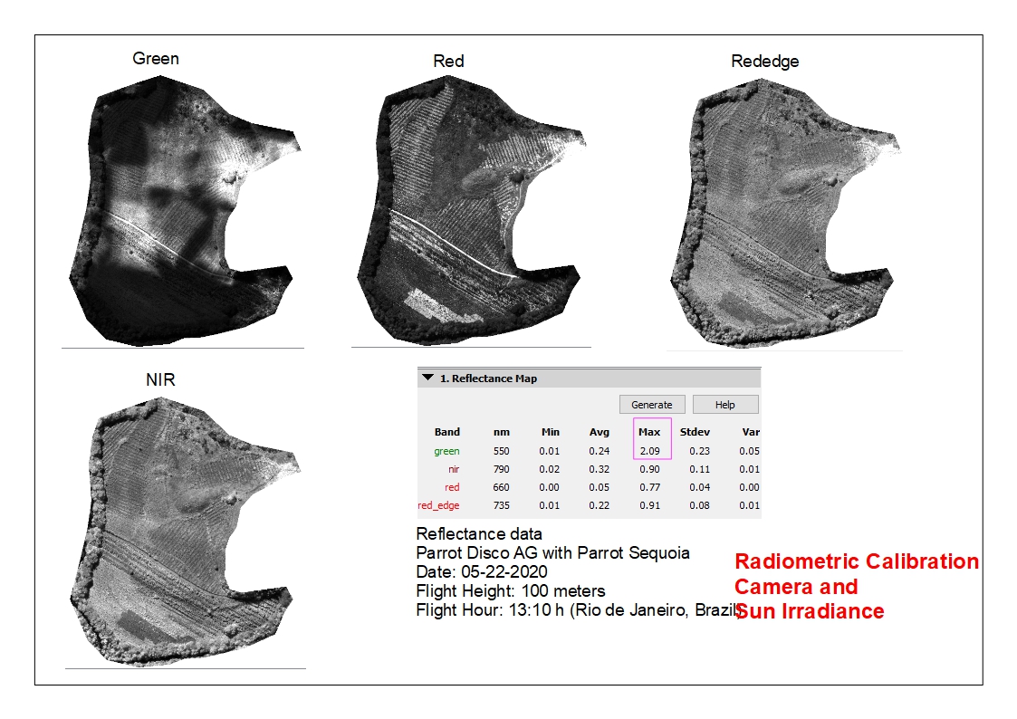

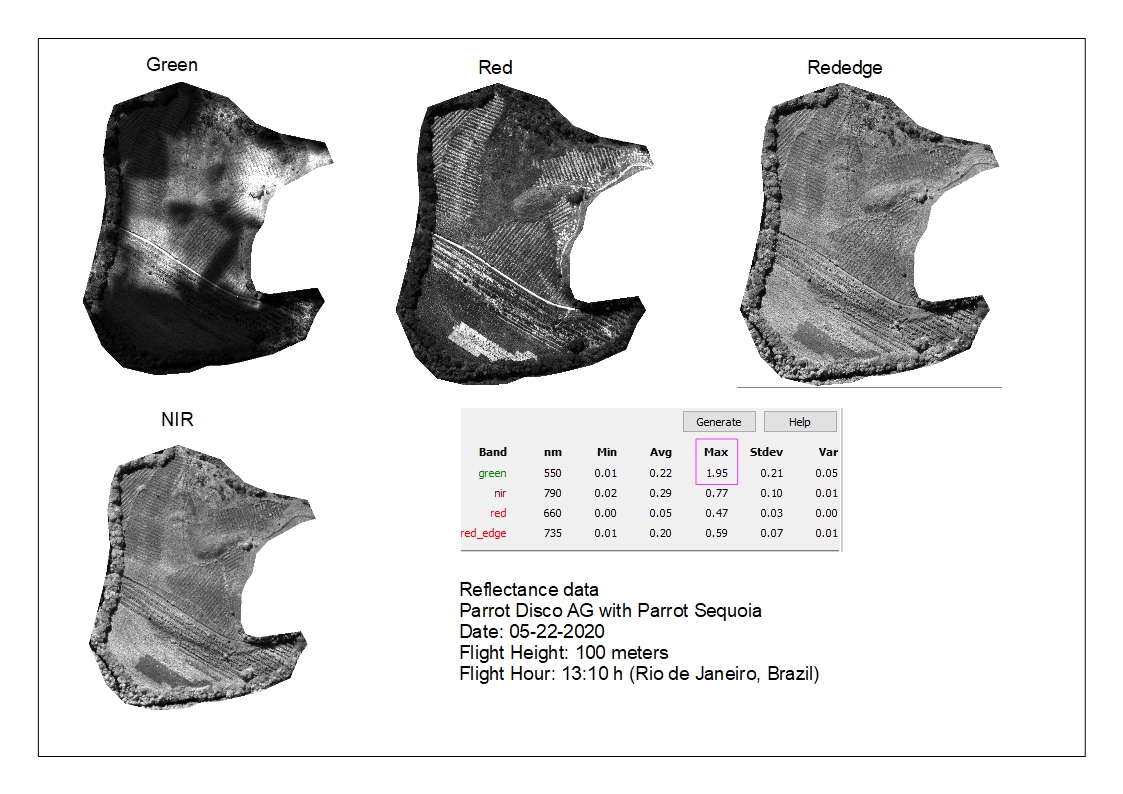

I did other two process with my data. Only radiometric camera correction and radiometric camera correction + sun irradiance sensor, using data from 05-22-2020.
Well, it is possible see that radiometric calibration using camera only had good results. Radiometric calibration on camera and sun irradiance do not have good results.
