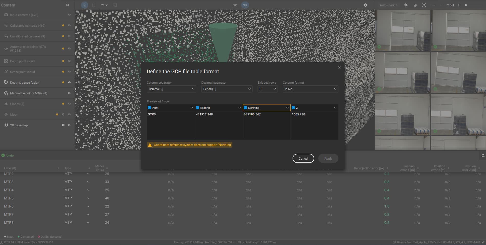

How can i chargue the .txt file?
none coordinate system works for me in the column format
Hi @nelsoncard_09,
What GCP coordinate system did you select? It seems that you selected a geographic coordinate system while your GCP table contains projected coordinates.
Cheers,
Daniele
You’re right, it was a problem in my coordinate system. I followed @Pierangelo_Rothenbuhler’s recommendation and it worked for me, thanks.
