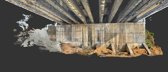

Here a screenshot of a 3D model I got by mixing Pix4DCatch and pictures with the best resolution with the Photo App iPphone, computed with Pix4DMapper:
I used tie points and GCP. But I got difficulties because of a bad georeferenced pictures with Pix4DCatch which were absolutely not well oriented.
The result is better than the Pix4DCatch alone + Pix4DMapper but request more time, first to point out GCP and tie points in the 2 set of pictures, second to compute the whole project.
@ totalsurvey2-xxx What was your purpose, if I can ask?
- What went wrong in this project?
- Is there the possibility to choose some images and discard others on “cloud”, like in desktop version?
My purpose was:
1- test the Pix4DCatch workflow + Pix4DMapper (Web & Desktop)
2- compare the results in both cases which were:
- Pix4DCatch + Pix4DMapper (Web),
- Photos with iPhone full resolution + Pix4DMapper (Desktop).
3 - integrate 3D model points cloud in Acad work for helping to construct and control 3D volume
Note that the bridge has been surveyed with traditional methods (total station) to construct the 3D volumes (piles, beams etc…).
