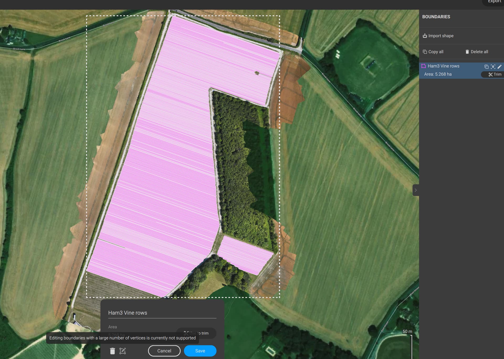

Hi Jose,
So I have hit the limit of sub-polygons, almost completed the field. This is irritating. I can’t even edit to delete some of the sub-polygons in order to split the vine block into two areas. I’ve spent hours on this and hit a brick wall. Now I have to give the client one large report and a ridiculous little one covering just 37 rows!

Hi,
Yes, the problem is the 1000 subpolygons limitation. You have to split it in 2 files in order to import them as boundary in Pix4Dfields.
Sirio
For those complex shapefile boundaries, it may make sense or its your only option to either split the field so Pix4Dfields can still handle it, or you need to mask the data/trim the data in QGIS and then import them in Pix4Dfields for the analysis.
Hi, just following up on this; has there been any improvement on the boundary/subpolygon limit, or the function to at least edit (to reduce) a boundry that has hit the 1000 subpolygon limit?
Hi Chris, that will be supported in PIX4Dfields 2.14 (the one after the upcoming 2.13).
