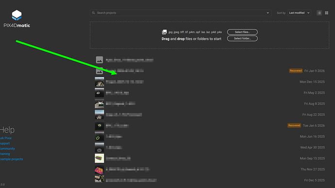

Now that Pix4DSurvey is merged into the new Pix4DMatic 2.0, how to we consolidate the project folders that were under the old Pix4DSurvey folder structure? We would use Send to Survey once completed processing in Matic to open them up in Survey, so the folder names are the same. Can we just drag and drop them into the Pix4DMatic folder to combine them, or do they need to remain separate? I’m just trying to clean things up now that I’ve uninstalled Survey.
Hello @scavendish
You can rearrange your folders and drag and drop the old PIX4Dsurvey projects into the PIX4Dmatic project folder. Please note that when you do that, even though you can open these PIX4Dsurvey files without any issue, initially, these projects have to be opened manually within PIX4Dmatic before they start to appear in the home screen.
If you face any issues, please let me know,w and I will help you figure out the solution.
