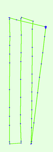

Hello Eddison,
Can you attach the project log file as well as the quality report? These will tell us much about your project and what might be going on. We will take a look at them and see what we can do.
Thank you for uploading. I believe the problem has to do with your image acquisition. There appears to be inconsistencies with the image overlap. The images should be at a very regular intervals. In your case the images appear to have a very random spacing and as a result the overlap will be inconsistent.
This can be a big problem with thermal bands since the resolution of thermal is very low. When trying to create thermal maps we recommend using very high overlap. Perhaps 90% both frontal and side.
I hope this helps.
80% might be fine but your image acquisition is inconsistent. The blue dots are where the images were taken. They should be at very regular intervals. Instead they are grouped tighter in areas and in other areas the gaps are bigger. So your overlap varies throughout your project. This will cause problems.
I suggest reflying and increase to 90% and make sure the overlap is consistent throughout your project.

The image exif tags clearly indicate irregular spacing of the images. Because thermal resolution is very low it requires the overlap to be 90% in order for sufficient keypoint to be generated. Because there are gaps the overlap will drop in those areas.
