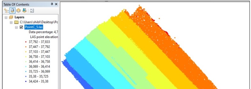

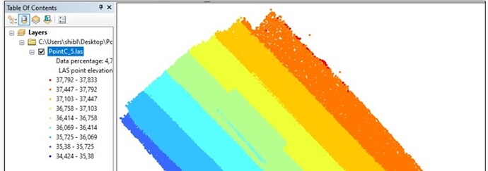

I have taken a series of overlapping oblique images of a building facade with an iPhone camera (with geotags) and generated a point cloud and orthomosaic in Pix4D. When I import the point cloud and orthomosaic into eCognition, it shows that the point at the ground adjacent part of the facade has a lower Z value and the point of the upper part has a higher Z value but I need “camera to facade distance” as Z value to help extract cracks on the facade using OBIA in eCognition.
Later I generated point cloud and mosaic by deleting geolocation information and selected “Arbitrary”
(output) coordinates in Pix4D. Still, the Z value is the height above the ellipsoid (according to WGS 1984), not the distance from camera position to facade. What can I do?!
DSM|541x500

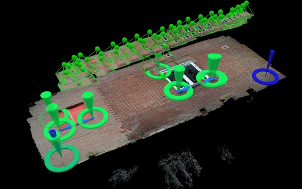

I am facing a new problem. This is the point cloud layer with scale and orientation constraints added.
I see some problems with it. They are-
  • point density is not the same throughout the whole facade
  • some noise
First, I cleaned the noise and clipped the point layer as below-

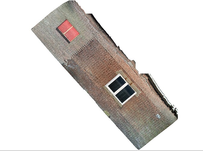

Then, I run the third process (ortho mosaic & DSM).
Results
Got the following ortho mosaic and DSM
It is notable that the ortho mosaic and DSM are not generated according to my point cloud clip.

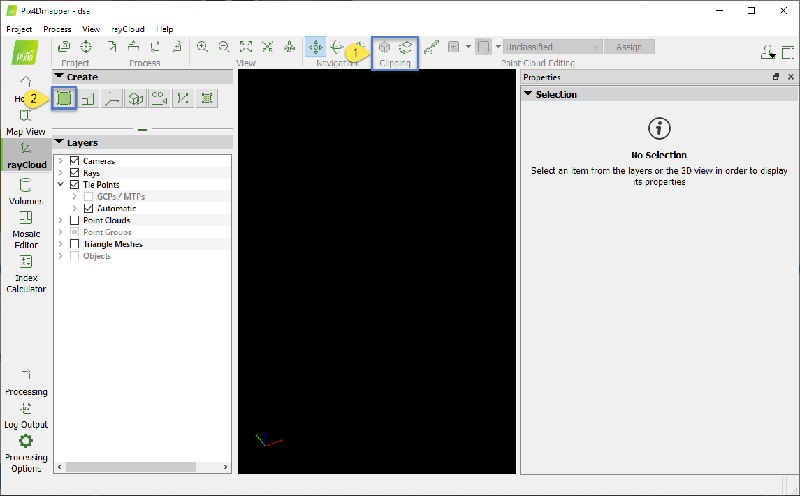

@m.s.hossain-2, thank you for the screenshots.
Instead of using the Clipping tool (1), you should use the Processing Area (2) to limit the point cloud.
I hope this helps,
Thanks a lot. I think this time it will work. Regards, Selim
