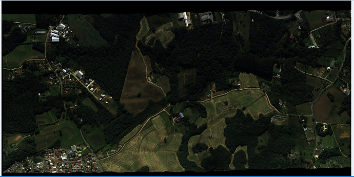

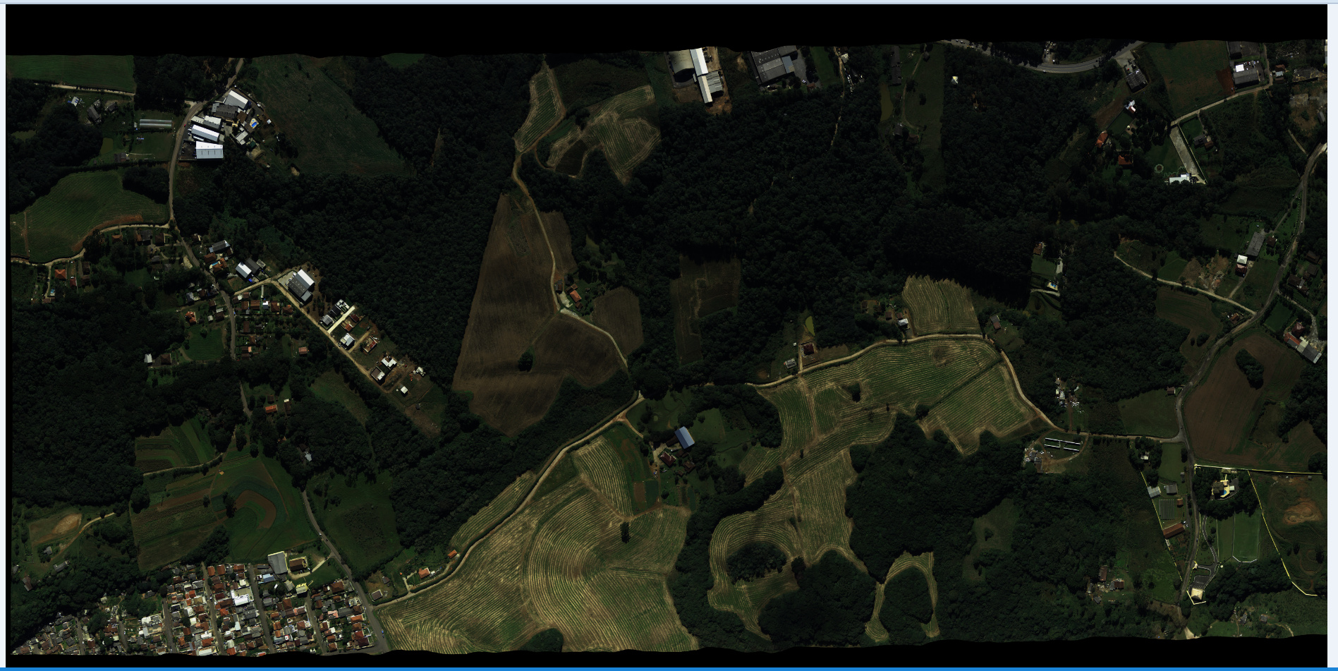

generally, all sensors come bundled with some tool like that, then the major problem is to deal with the fact that each column in image have its own perspective center.
