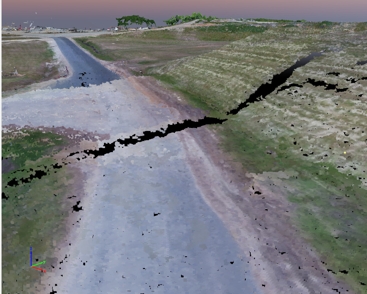

On a road surface the point cloud shifts up for about 20’ then back down to correct level. Can you help fix this problem? See attached screen clip.

Thank you for uploading the quality report. I recommend adding MTPs to the problematic areas and marking more GCPs on more images. For more information on how to add MTPs, please refer to the link below.
