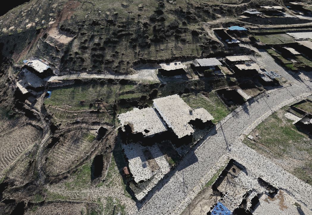

The below image is the original point cloud without deleting or disabling any thing:

Thanks for trying out Pix4Dsurvey! You’ve got a challenging project there for terrain/non-terrain classification, but you should be able to get better results from Pix4Dsurvey. I’d try decreasing the sample distance, but then you’ll still have some flat roofs remaining.
For those, you can manually reassign points from terrain to non-terrain. Just hold down CTRL and drag your cursor with the left mouse button held down. That will select, and then you can right click to Assign to a new classification.
https://support.pix4d.com/hc/en-us/articles/360031902532-Pix4Dsurvey-FAQ#label2a has some more details too.
Does that help? Once you are happy with the terrain, you can continue on to a grid of points and then a TIN. The TIN can also integrate any breaklines you create.
