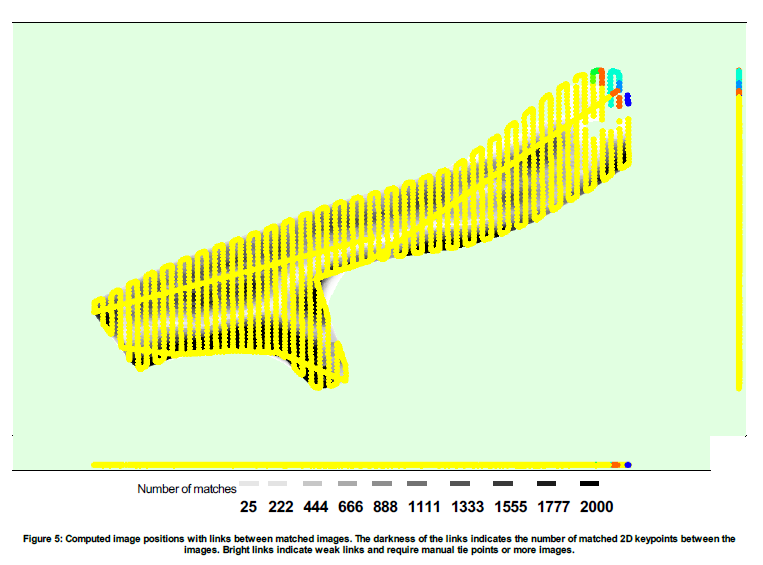

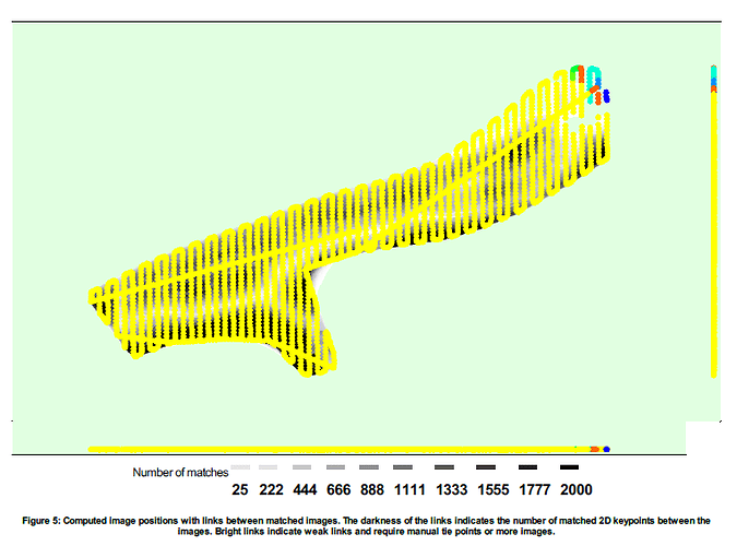

Hello, i also have 3 blocks showing up on a beach survey recently completed. I cannot locate these different blocks to try fix. Can someone assist on how to identify where the 3 blocks are?
It is creating multiple height layers in a particular area of the survey.
The quality report looks very good. The presence of three blocks may seem concerning, but it’s a bit misleading. The screenshot below highlights their locations:
The yellow block represents a single, continuous area that covers the majority of your project.
The red and green blocks are small, isolated sections near the water.
Thanks Mike, does this mean that multiple blocks (if in a small area like the above or below image example) are not impacting overall accuracy? I below job has 7 blocks. Id prefer to remove them, but wont worry if not a big deal. As i understand these blocks are created over areas of water where stichting has trouble.
