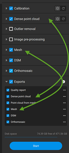

Hello @tibor.vari
I understand the confusion. The reason the Quality Report is the only option available for export is that this particular project has not been processed yet, thus no other outputs (Dense point cloud, Mesh, DSM, etc) are available. In order to enable the other export options, you have to either have processed them before or select the processing step alongside the export option (see image below):
