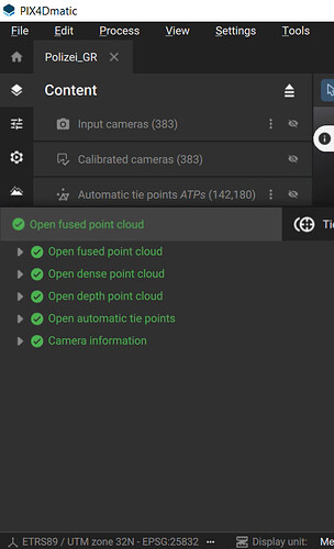

I have fully processed a project using Pix4dCATCH within Matic and am trying to share it via google drive or drop box. I have tried both methods and every time I open the root file, it fails to import the ATP’s, Depth & Dense PC, the Depth and Dense Fusion, and Mesh. I tried compressing the entire project folder to a .zip file and still have had no success. Any help is appreciated.
@tmixon I’ve tried the following myself, and it worked:
  1. Zip the entire project folder. Zip the root folder that typically includes all of the following elements:
  2. Send the ZIP file to another computer.
  3. Extract the ZIP file.
  4. Double-click the root.p4m file. PIX4Dmatic opens and loads the results.
Can you confirm you tried this?
Note that you also need to share the images separately and re-establish the link to them in case you need to do more than just view the project results.
