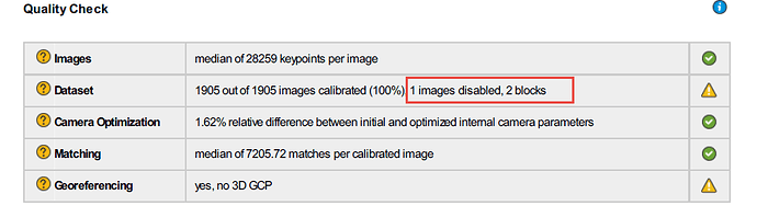

Hello @josh.abbott, You can find these information on the quality report.
So does the yellow, red and green represent the 3 blocks?
The height errors i have been experiencing are not near the red and green. They are in the middle of the yellow section.
Yes, that is correct. The red, green and yellow are three layers. If you are having issue on other area, can you send me the screenshot showing the issues? Usually, if you see the issue on those area it might be due to multiflight mission, drastically change in the lightening condition and so on. We recommend adding mtps in that area.
