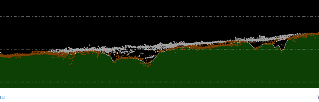

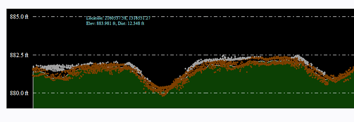

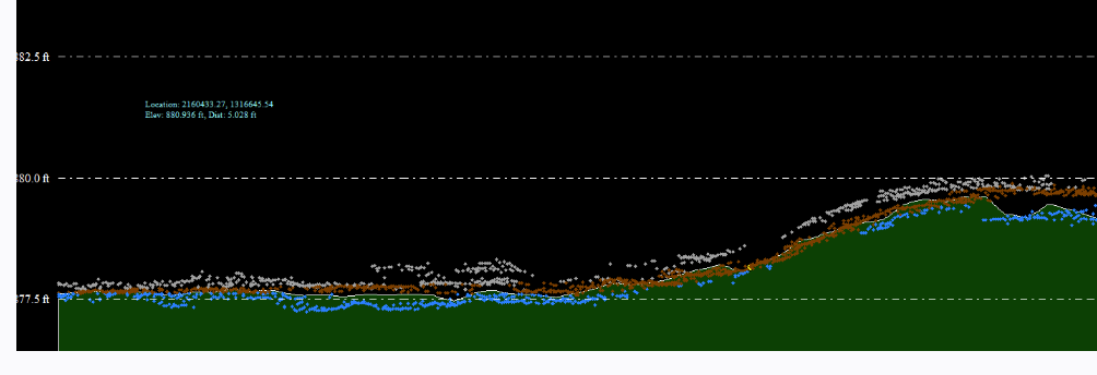

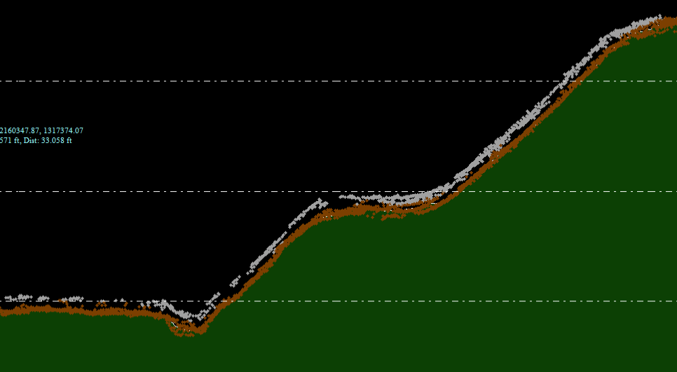

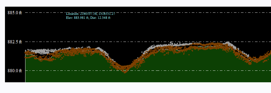

We are seeing separation in the point cloud produced in Pix4d. We typically export out the point cloud into another program to clean up and classify. This doesn’t happen every project but in this case we are seeing a separation in the cloud at the ground. See the attached screen shots in the posts below. Has anyone seen this before?
This separation is causing inaccuracies in the final surface if we don’t manually re-classify the separated points.
I have attached the quality report, which I don’t see anything unusual. Bentley 20210113_report.pdf (2.0 MB)
Yes it is one point cloud, the points are separated by a tenth or so. When we run a auto classification the grey is un-classified and the brown is ground classification.

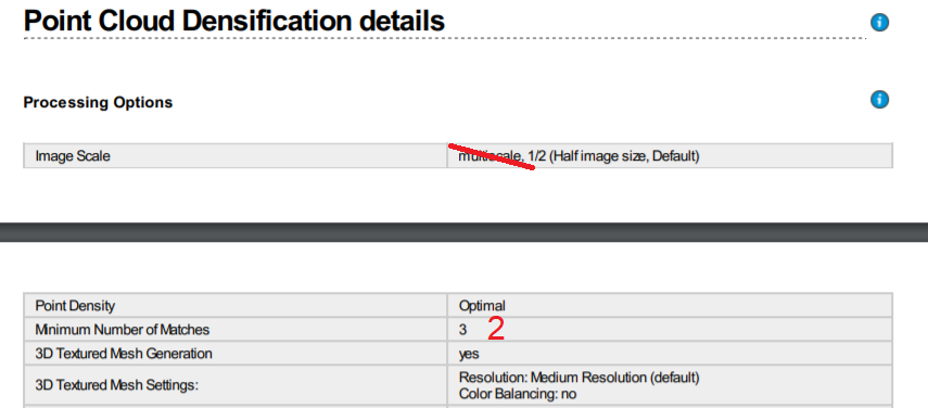

You could try to eliminate this noise by unselecting the Multiscale option and changing the Minimum Number of Matches to 2. I believe it should help. But, let me know!
